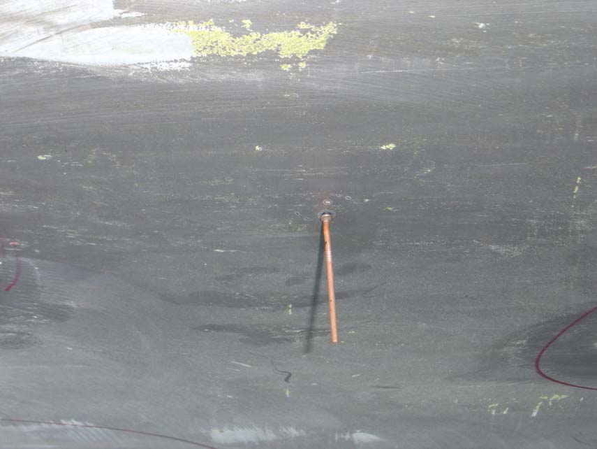

Well, I had a few visitors today and got quite a bit done or should I say farther along. Its turned out to be more work than I first thought. Turns out there was a lot of bondo in this car in places I didnt even think of. The worst was in the passenger rear fender. Just behind the wheelwell. Looks like a large ballpeen hammer hit and several small ones on top of that. Depth was about 3/4 on an inch. The worst part is the lip damage. I dont know if I can get that one out so I may be welding in a new replacement section. It wont be the first time I have had to do that. Here is the way to properly pull dents back out if you can get your hands on one. I love this thing, it works so cool.

skline   There were dents where the studs are welded on, th...   Mar 10 2005, 02:45 AM
