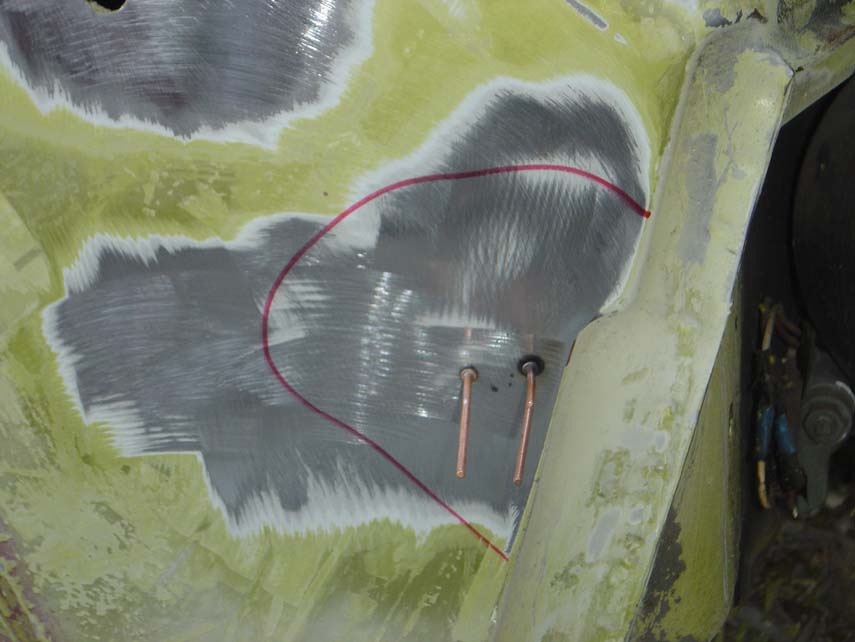

skline   Well, I had a few visitors today and got quite a b...   Mar 10 2005, 02:40 AM
skline   Another shot in a different spot.   Mar 10 2005, 02:41 AM
skline   There were dents where the studs are welded on, th...   Mar 10 2005, 02:45 AM
skline   The worst dents to remove in the car.   Mar 10 2005, 02:46 AM
skline   The part I just happened to have on the side of my...   Mar 10 2005, 02:47 AM
skline   The drivers side rear is riddled with a flock of l...   Mar 10 2005, 02:51 AM
