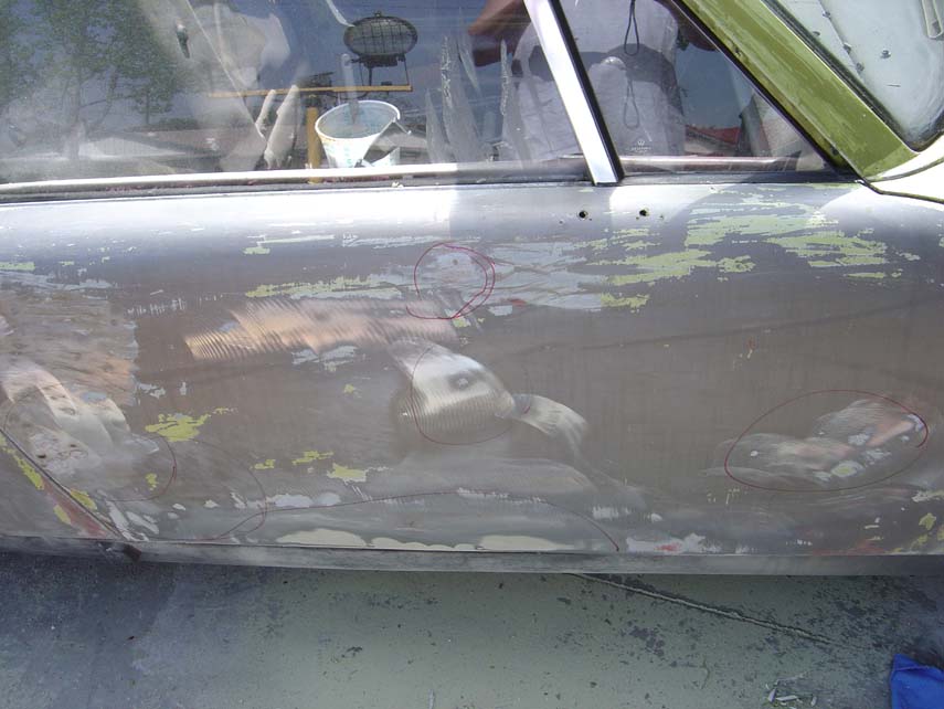

post Mar 10 2005, 02:45 AM
Born to Drive
Posts: 7,910
Joined: 26-December 02
From: Costa Mesa, CA
Member No.: 17
There were dents where the studs are welded on, they are pulled out almost perfect. I will go back and grind off the studs and finish it with spot putty. All the red circles are where dents are. Some are worse than others. The next few days will be working on removing all the dents and welding in metal where the side marker lights were and the holes where the sail trim was. The green paint is not coming off very easy. Some places it is like the metal has turned green. For the most part, the car is stripped. I will take it the rest of the way with sanders.
