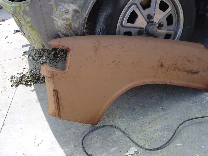

This will be my step by step driveway strip and paint thread. This may not be the way everyone will do it, but this is the way I will do mine. If you like it, you can do it this way also. If not, then you can take it to a body shop and pay $3k to $5k for a paint job. You could also do different variations and run the cost up. I will post what I spend on this entire process. Some have said its like hitting your self in the head with a hammer, ok, this will be my first smack in the head.

The part I just happened to have on the side of my house. Amazing the crap I collected over the years.

skline   The part I just happened to have on the side of my...   Mar 10 2005, 02:47 AM
