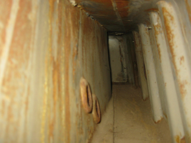

At least the hell hole looks good. How many people actuall get to look inside their longs? (IMG:http://www.914world.com/bbs2/html/emoticons/huh.gif) Not sure that's really something to be proud of though. (IMG:http://www.914world.com/bbs2/html/emoticons/unsure.gif)
At least they looked pretty good. Just a little surface rust.
