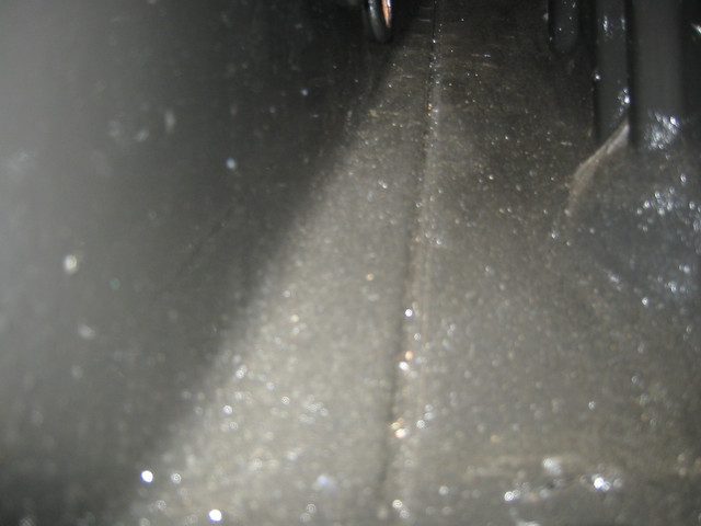

Got in there and cleaned as best I could then got a spray gun with a long wand and shot the whole inside with por15.

rhcb914   Got in there and cleaned as best I could then got ...   Mar 12 2005, 06:44 PM
