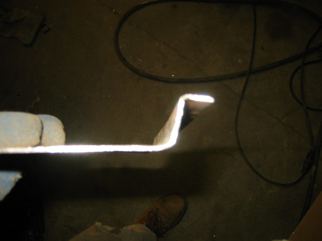

rhcb914   Here's the rocker patch I made.   Mar 12 2005, 06:58 PM
