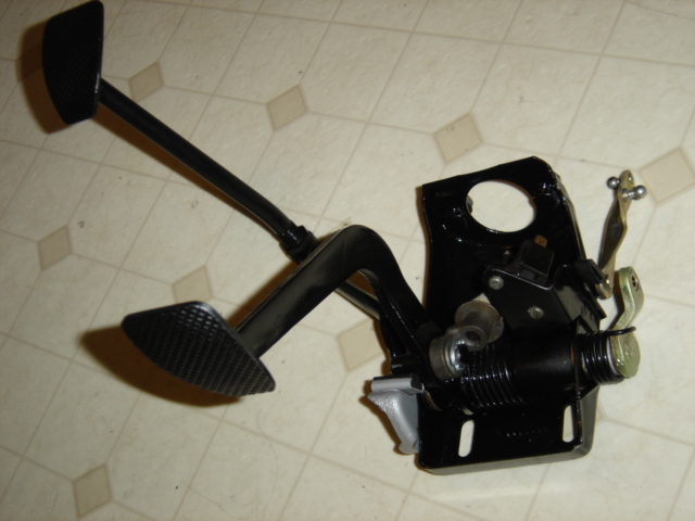

QUOTE (CptTripps @ Mar 22 2005, 09:17 PM)
I'm waiting on my pedal cluster to come back from being rebuilt, so I can't test them out yet anyway.
With any luck I COULD be driving it around the block in a few weeks!
Here it is, ships tomorrow morning. Thank you for allowing me to do your re-build. I threw in a brake light switch, as the one on your cluster was broken when it arrived. Not sure if it was like that when you shipped it.
Martin Baker
NORTH BAY 914
