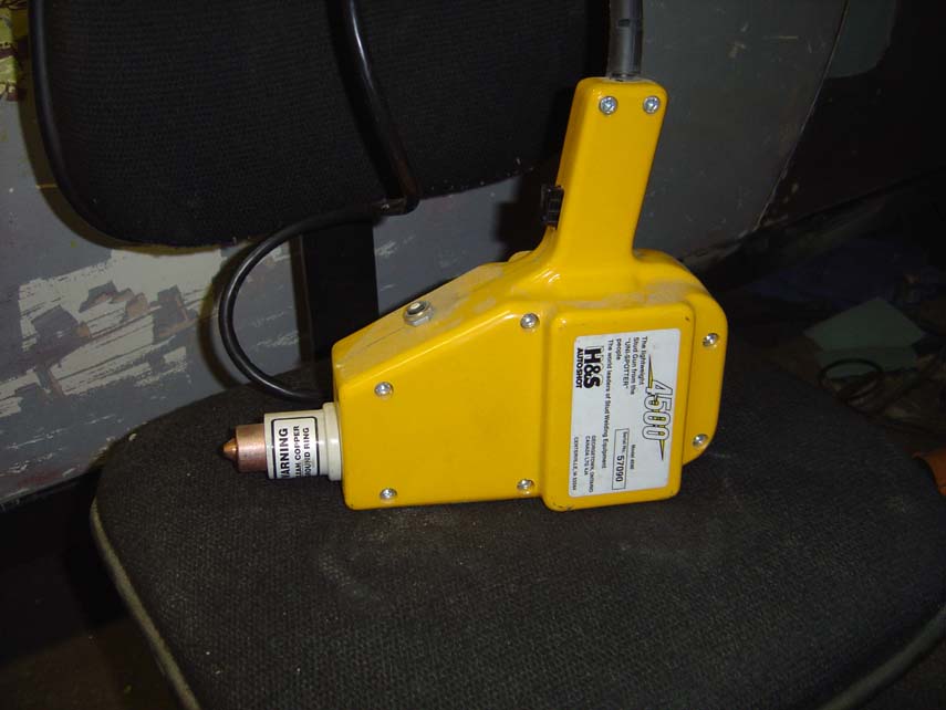

One of the best investments I made was this little tool. It was about $350.00 a few years ago but I have seen them for less in recent times. Its for the areas you cannot get in behind. It works awesome. The only problem I have is with the damn slide hammer. Everytime I use it I seem to slam my hand or fingers with it. It makes nice little blood blisters. But the tool does work and very well.
