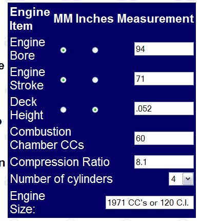

If your combustion chamber is in fact 60cc's and you have .022" deck height and you used a .030 spacer you would have a compression ratio of around 8.1 / 1.

ThinAir914   Thanks guys... Now, about deck height. I assembl...   Mar 27 2005, 07:33 PM
Mark Henry   You should figure out your proper CR then get cust...   Mar 27 2005, 07:52 PM
Joe Sharp   Mark: Your trying to make an engine builder out of...   Mar 27 2005, 09:12 PM
ThinAir914   That's OK Joe. I want to understand why, not ...   Mar 28 2005, 12:20 AM
MarkV   You have to cc the heads and allow for the dish in...   Mar 28 2005, 12:29 AM
ThinAir914   I was using the value of 60cc that Mark Heery prov...   Mar 28 2005, 12:54 AM
MarkV   If your combustion chamber is in fact 60cc's a...   Mar 28 2005, 01:08 AM
Mark Henry   Things like flycutting the head can change figures...   Mar 28 2005, 08:04 AM
