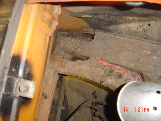

I'm repairing the battery tray and related hot spot. (IMG:http://www.914world.com/bbs2/html/emoticons/unsure.gif)
I need your tech advice on the procedure.
I want to first make paper templates and then fit the sheet metal. Maybe hang it with rivets or screws before the big weld off.
Stock look is not important to me. Just needs to drain and support the new battery tray and pedestal.
I will sand off the remaining surface rust before applying rust converting primer. I'm scratching the naval jelly approach.
Also, please post pics of your repaired areas.
Here's my project.
Thanks, as usual! (IMG:http://www.914world.com/bbs2/html/emoticons/clap.gif)

trekkor   metal fabbers...report.   Dec 30 2004, 12:00 AM

JOHNMAN   Man, that's a big hole. You have your work cu...   Dec 30 2004, 12:36 AM
airsix   In the picture below I've marked off the piece...   Dec 30 2004, 12:46 AM
GWN7   You can also trim the holes to make square patches...   Dec 30 2004, 01:48 AM

Bleyseng   Set up your pieces like Ben said but buy the engin...   Dec 30 2004, 07:16 AM
Gint   Ben's plan makes sense to me. Id prolly also ...   Dec 30 2004, 07:17 AM

greg.treadway   Looks to me like you need an engine shelf, inner w...   Dec 30 2004, 12:10 PM
Aaron Cox   wow.... that looks like the way to go greg, how m...   Dec 30 2004, 12:15 PM
greg.treadway   The pieces are not cheap. The engine shelf retails...   Dec 30 2004, 12:31 PM
airsix   Let me elaborate a little on my 'beat to fit...   Dec 30 2004, 12:50 PM
trekkor   Thanks for the report. I'll be back at it in ...   Dec 30 2004, 02:52 PM
