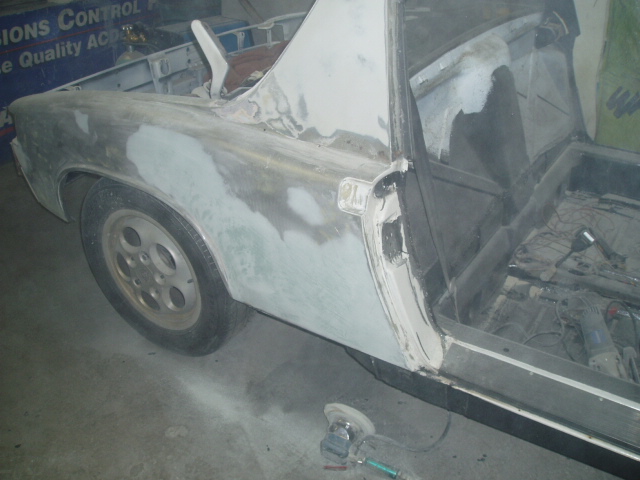

So I just realized that I'm about 2mos into my restoration, and don't really have a thread for the progress. I have my Floor Pan thread, but I'm done with that (for now) and need a place to put the REST of the work I'm doing.
I made up a bunch of posts, and will put them here, in this thread. I'll then keep going as I progress. Some of these pics are dupes that you have seen before in other threads, others are new.
Here's the starting point, on Jan 12th, 2004.

CptTripps   Spent the whole weekend doing more body work. I wi...   Apr 3 2005, 09:33 PM
CptTripps   So I marked out a larger section to cut out and re...   Apr 3 2005, 09:36 PM
