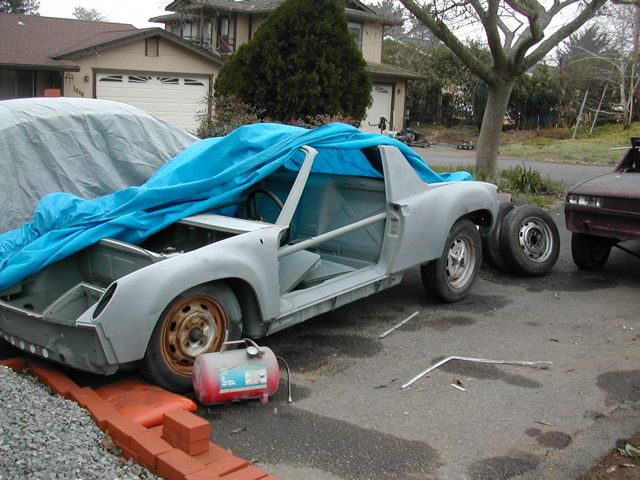

I hacked into my parts car to gain an even clearer view of the world inside the long. I'm here to share my pictures. (IMG:http://www.914world.com/bbs2/html/emoticons/wink.gif)
Here's how I hacked in. I wouldn't recommend this tactic on a real project, but I just wanted to get inside without losing the shape and perspective of things. I just took a hack saw and cut into the top of the long and then drilled out all the spot welds along the top.

No leave it out while dipping and weld a bar from the dash to the back pad wall at each door. Keeps the car together when they're pulling it out of the acid bath.
