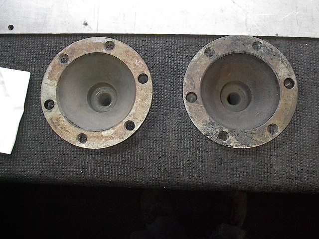

For Karl et al:
Here are some pics of sportomatic flanges. Another possible issue with the one I'm using: the seal area is shorter. The problem with the other one is that the outer diameter of the area that slips into the differential casing is too small.
They are both stamped with the same part number: 901 332 209 15

meursault   For Karl et al: Here are some pics of sportomatic...   Jun 19 2003, 11:42 AM
meursault   Here's another:   Jun 19 2003, 11:43 AM
meursault   I thought I had a side-view pic of the flanges, bu...   Jun 19 2003, 11:47 AM
