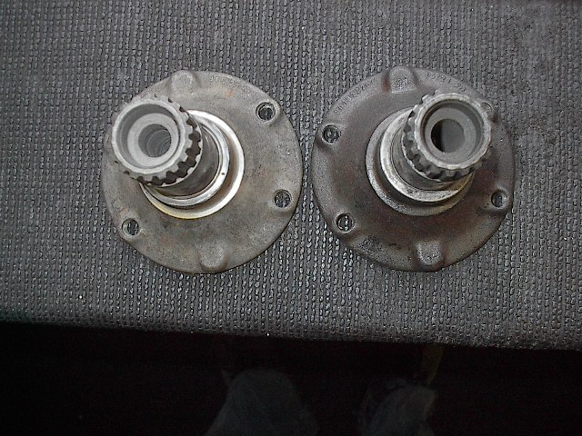

meursault   For Karl et al: Here are some pics of sportomatic...   Jun 19 2003, 11:42 AM
meursault   Here's another:   Jun 19 2003, 11:43 AM
meursault   I thought I had a side-view pic of the flanges, bu...   Jun 19 2003, 11:47 AM
Brad Roberts   I'm playing catch up since I have been away fr...   Jun 19 2003, 01:31 PM

Brad Roberts   That pull assembly is not your answer. You'll ...   Jun 21 2003, 03:46 PM
