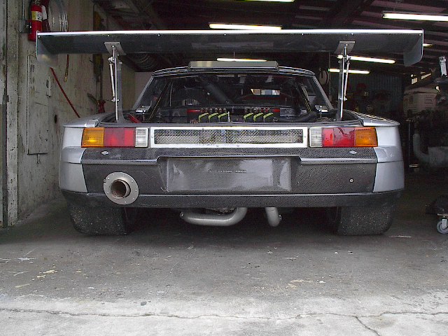

Some more "teaser"pics of the racecar. It's got one of them schoolbus exhausts, eh?
