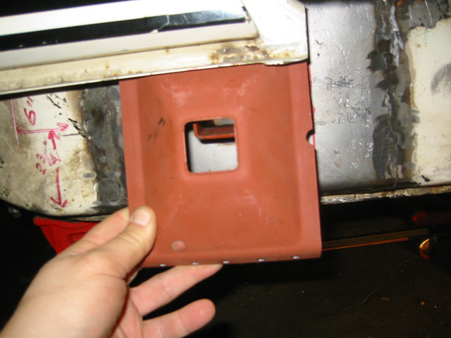

It's been a while since I last updated this thread. Here are some of the pictures from a few weeks ago. I have almost completed the drivers side repair (the rust was worse) but unfortunately I didn't photograph that side much at all. It's a lot of work! (IMG:http://www.914world.com/bbs2/html/emoticons/smash.gif) At least the car will be solid and ready for the summer! I'm really itchin for some 914 driving time now that the spring weather is here.
This pic is of test fitting the jack post support.

rhcb914   Here is the passenger side support prior to being ...   Apr 13 2005, 09:06 AM
rhcb914   Here it is welded on with seam sealer and a quick ...   Apr 13 2005, 09:09 AM
