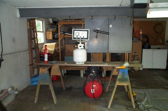

Here's the basic setup. I was going to buy sheet metal as a heat shield/reflector, but Pam suggested using some old shelving sections. Very good call on her part.
The heater (a Mr Heater two element model) was 28000 BTU. I did the entire front suspension on less than one bottle of propane.

Lawrence914-6   Here's the basic setup. I was going to buy sh...   Jun 26 2003, 03:49 PM
Lawrence914-6   The heater really wasn't this far away.. but i...   Jun 26 2003, 03:50 PM
