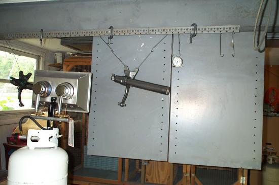

The heater really wasn't this far away.. but it's just a good pic of the setup.

Jeff Bonanno   Rusty, wha's the electro-gizmo thingy for in ...   Jun 25 2003, 10:10 PM
Lawrence914-6   The yellow box in the picture? It controls curren...   Jun 25 2003, 10:47 PM
Jeff Bonanno   Rusty, got it! thanks - have been wondering ...   Jun 25 2003, 10:52 PM

Lawrence914-6   Here's the basic setup. I was going to buy sh...   Jun 26 2003, 03:49 PM
Lawrence914-6   The heater really wasn't this far away.. but i...   Jun 26 2003, 03:50 PM
