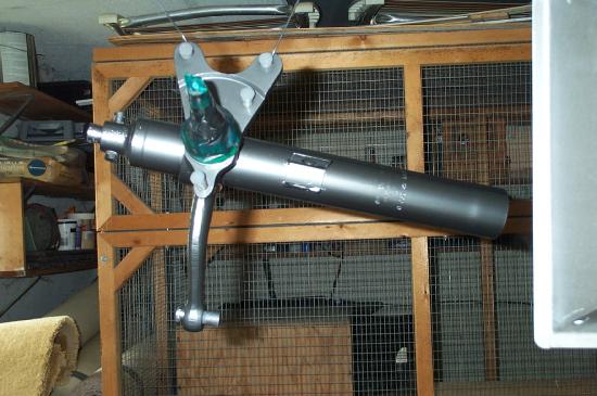

Taped and plugged and coated in "smoke chrome".

Lawrence914-6   Taped and plugged and coated in "smoke chrome".   Jun 26 2003, 03:51 PM

AZ914   The Packers...? :finger2: BTW.. the parts loo...   Jun 26 2003, 04:04 PM
Dave Cawdrey   What goes in that cage?? :o   Jun 26 2003, 04:04 PM
