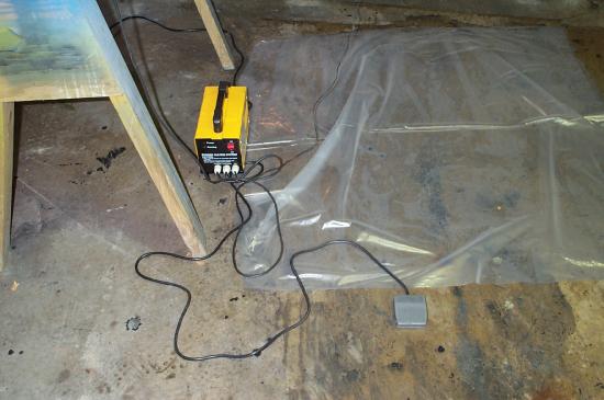

The foot pedal is to activate the negative charge (on the item). It was just as easy to hold the small pedal switch in my hand when working on smaller parts.
The drop cloth is to catch overspray. Overspray wasn't bad at all on the metallic smoke chrome. The clearcoat powder was like spraying powdered sugar. I think part of the struggle was the high humidity.
Good thing: catch your old powder, and you can reuse it if it's not full of dirt (hence the dropsheet). Just keep it separate from the new powder.

Jeff Bonanno   Rusty, wha's the electro-gizmo thingy for in ...   Jun 25 2003, 10:10 PM
Lawrence914-6   The yellow box in the picture? It controls curren...   Jun 25 2003, 10:47 PM
Jeff Bonanno   Rusty, got it! thanks - have been wondering ...   Jun 25 2003, 10:52 PM
