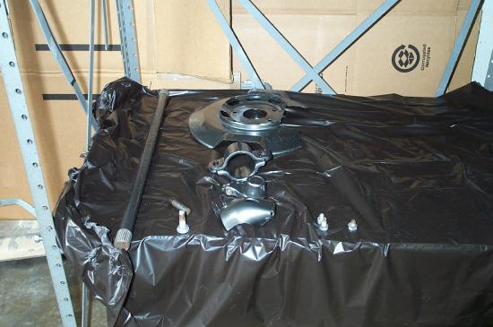

Some items before the clearcoat.

Lawrence914-6   Some items before the clearcoat.   Jun 26 2003, 03:55 PM
