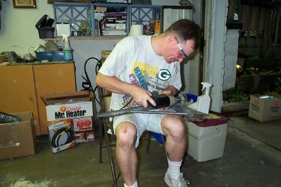

Cleaning up some spots before I use Opsho/Rust Mort/Rust Free/your favorite phosporus based rust treatment.
Yeah, the wire wheel bit my knee. (IMG:style_emoticons/default/rolleyes.gif)
