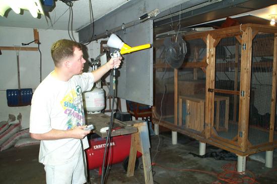

I'm about 3 hours into my first powdercoating adventure. Man, this stuff rocks. Again, Ginter is right. If you have a garage, and don't have your own setup - you might want to rethink that.
My setup from Columbia Coating, including about 8 pounds of various metallics/clears was about 200 bucks. Pam picked up some extra natural corks (because she saw it on American Chopper). They seem to work as well as the synthetic/plastic corks for plugging bolt holes.
I will post pictures later... gotta get back out and monitor temps.

Recoating the brake shields after scuffing them with 220. This was an adventure, and I learned several things.
1. The thicker powdercoating gets, the harder it is to apply the next layer (of clear or whatever). The electrical charge (negative at the part) is weaker, and attracts less positively charged powder.
2. Very thin metal parts cure MUCH faster than smaller ones. You can over-cook quickly if you're not careful. Watch how the powder flows, rather than the exact temp.
3. I can't imagine ever using an oven. That must be so much harder, because of knocking the powder off, etc. In my setup, I hung them exactly as they'd be heated, powdered them, and transfered them (on the hooks) to the heating area.

Lawrence914-6   Here's the basic setup. I was going to buy sh...   Jun 26 2003, 03:49 PM
Lawrence914-6   The heater really wasn't this far away.. but i...   Jun 26 2003, 03:50 PM

Lawrence914-6   Close up of the gun itself. It's made of stur...   Jun 26 2003, 03:52 PM

Lawrence914-6   The foot pedal is to activate the negative charge ...   Jun 26 2003, 03:54 PM

Lawrence914-6   Spraying an A-Arm. Please note the "ground strap"...   Jun 26 2003, 04:04 PM
Lawrence914-6   More spraying, same part. The powder is charged, ...   Jun 26 2003, 04:06 PM
