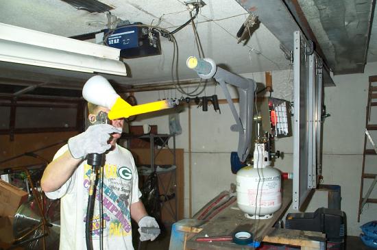

Spraying an A-Arm.
Please note the "ground strap" hooked to the end.
1. Grounding points don't work well through masking tape.
2. If your hanging hook contacts the metal part directly, you can ground on the hook. That's often much easier.
3. You need to be creative with your hanging methods. I plugged the ends of the A-Arm and then jammed the hooks into the plugs.
4. Wherever you hang an item will leave a small dimple during the curing process, obviously.

AZ914   The Packers...? :finger2: BTW.. the parts loo...   Jun 26 2003, 04:04 PM
Dave Cawdrey   What goes in that cage?? :o   Jun 26 2003, 04:04 PM
Lawrence914-6   Spraying an A-Arm. Please note the "ground strap"...   Jun 26 2003, 04:04 PM
Lawrence914-6   More spraying, same part. The powder is charged, ...   Jun 26 2003, 04:06 PM
