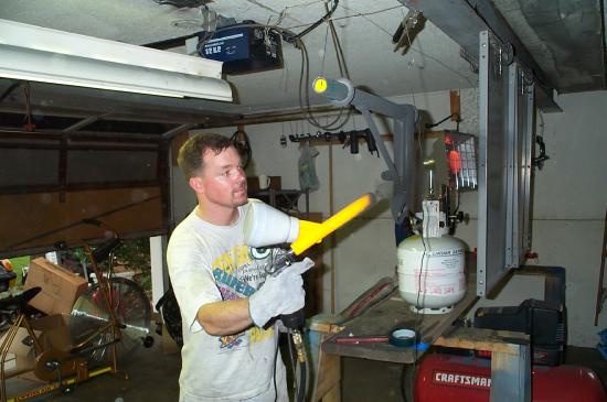

I'm about 3 hours into my first powdercoating adventure. Man, this stuff rocks. Again, Ginter is right. If you have a garage, and don't have your own setup - you might want to rethink that.
My setup from Columbia Coating, including about 8 pounds of various metallics/clears was about 200 bucks. Pam picked up some extra natural corks (because she saw it on American Chopper). They seem to work as well as the synthetic/plastic corks for plugging bolt holes.
I will post pictures later... gotta get back out and monitor temps.

More spraying, same part. The powder is charged, so most of it will go to the part like a magnet.

Jeff Bonanno   Rusty, wha's the electro-gizmo thingy for in ...   Jun 25 2003, 10:10 PM
Lawrence914-6   The yellow box in the picture? It controls curren...   Jun 25 2003, 10:47 PM

Lawrence914-6   Here's the basic setup. I was going to buy sh...   Jun 26 2003, 03:49 PM
Lawrence914-6   The heater really wasn't this far away.. but i...   Jun 26 2003, 03:50 PM
Lawrence914-6   Taped and plugged and coated in "smoke chrome".   Jun 26 2003, 03:51 PM
Lawrence914-6   Close up of the gun itself. It's made of stur...   Jun 26 2003, 03:52 PM

Lawrence914-6   The foot pedal is to activate the negative charge ...   Jun 26 2003, 03:54 PM

Lawrence914-6   Spraying an A-Arm. Please note the "ground strap"...   Jun 26 2003, 04:04 PM
Lawrence914-6   More spraying, same part. The powder is charged, ...   Jun 26 2003, 04:06 PM
Lawrence914-6   Cooking clear onto a strut. Clear requires some p...   Jun 26 2003, 04:07 PM
