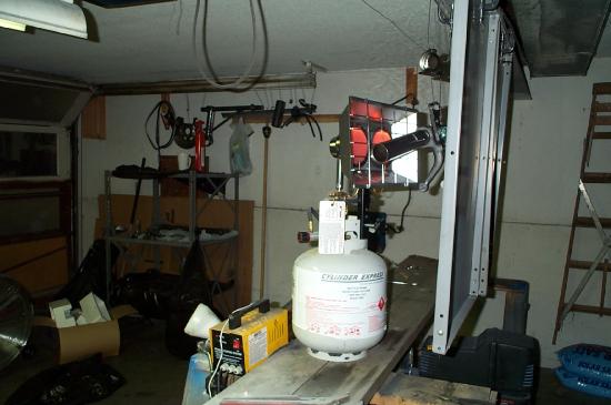

I'm about 3 hours into my first powdercoating adventure. Man, this stuff rocks. Again, Ginter is right. If you have a garage, and don't have your own setup - you might want to rethink that.
My setup from Columbia Coating, including about 8 pounds of various metallics/clears was about 200 bucks. Pam picked up some extra natural corks (because she saw it on American Chopper). They seem to work as well as the synthetic/plastic corks for plugging bolt holes.
I will post pictures later... gotta get back out and monitor temps.

Cooking clear onto a strut.
Clear requires some practice. The finer the powders, the more difficult it seems to be to spray.

Jeff Bonanno   Rusty, wha's the electro-gizmo thingy for in ...   Jun 25 2003, 10:10 PM
Lawrence914-6   The yellow box in the picture? It controls curren...   Jun 25 2003, 10:47 PM
Jeff Bonanno   Rusty, got it! thanks - have been wondering ...   Jun 25 2003, 10:52 PM

Lawrence914-6   Here's the basic setup. I was going to buy sh...   Jun 26 2003, 03:49 PM
Lawrence914-6   The heater really wasn't this far away.. but i...   Jun 26 2003, 03:50 PM

Lawrence914-6   The foot pedal is to activate the negative charge ...   Jun 26 2003, 03:54 PM
