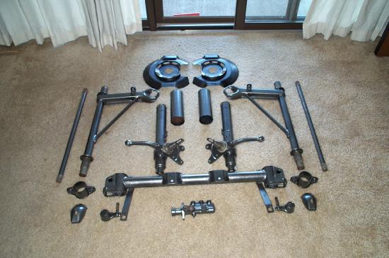

Here's the finished product, all spread out on the floor. The picture doesn't do it justice. Also added to the picture is the crossmember and the master cylinder that I'm rebuilding.
-Rusty
P.S. After several attempts at the brake shields, I ended up doing them with satin black powder. Even then, they didn't turn out exactly the way I wanted. Someday, I'll take the time to redo them.
