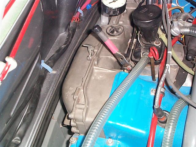

Here's pix I took last night of the ACS, classic german enginutty! (IMG:http://www.914world.com/bbs2/html/emoticons/biggrin.gif)

Here's my idea for a manual control cooling!
COLD POSITION - "UP"

ArtechnikA   and don't forget that one of those holes - i c...   Apr 27 2005, 08:07 AM

root   An old Porsche mechanic told me that it was Mg, (h...   Apr 27 2005, 11:14 AM

ArtechnikA   it acts and feels like a magnesium alloy; certainl...   Apr 27 2005, 11:19 AM
Borderline   I have a question..... in the photos the lower rig...   Apr 27 2005, 11:28 AM

root   Thanks Clay, I guess that solves the engine shroud...   Apr 27 2005, 06:37 PM
ArtechnikA   <...   Apr 27 2005, 06:45 PM

root   Ernie, I think you could be correct about the oil ...   Apr 28 2005, 06:04 AM
root   I took an old ;eaking bellows to work. Cleaned it ...   Apr 29 2005, 07:43 PM
Brad Roberts   Great job on the pics.. http://...   Apr 29 2005, 07:58 PM
root   WARM POSITION - "DOWN" http://ww...   Apr 29 2005, 08:21 PM
Brad Roberts   Be careful. If you forget.... bad day. The engine ...   Apr 29 2005, 08:36 PM
root   Thanks for the warning! If I blow the 1.7 th...   Apr 29 2005, 08:49 PM
