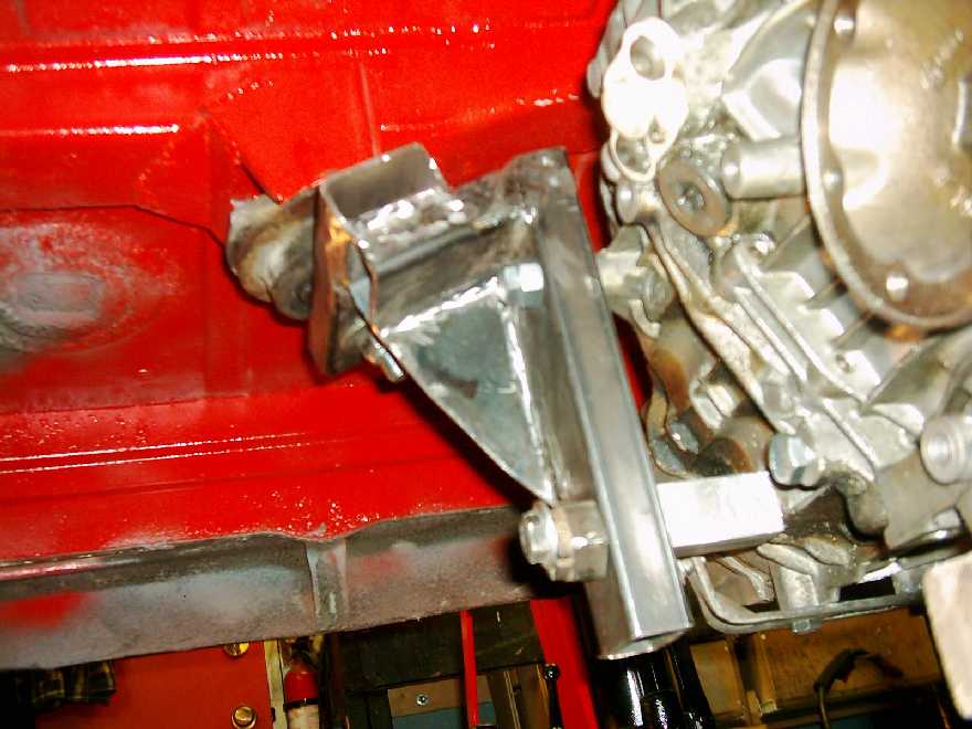

Felix:
The Axle flanges on the tranny and my (911 axles) are the same size, which if I
remember is 100 mm. with 6 bolts 8mm. The actual axles I will be using are likel
going to be VW bus axles which I understand provide a broader range of movement
and are the correct flange size. The length will be handled with axles spacers similar
to the RH (already have a mock up adapter for machining purposes) which will
speed up the process.
The alignment of the tranny output flanges is slightly to the rear with of the axle
flanges, however I have also modified my Front engine bar (DH) and Fabricated my
new tranny mounts to both be adjustable ( +- 1.5") in order to allow for later
installation of a FI trigger wheel off harmonic balancer when
I start phase II of this project and conver everything to the Corvette fuel injection
with MegaSquirt !
In my case the engine clearance look really decent and should not be a problem.
(Attached photo shows the trial fitting of Right side only mount for tranny, which
by the way is a 5 speed unit.)

ajracer   Felix: Should be an interesting porject and at le...   May 29 2005, 09:36 PM
ajracer   Photo # 2 Rear View (The mounts have been fabrica...   May 29 2005, 09:39 PM
neo914-6   Allan, The photos are a bolted Boxster 5 speed to...   May 29 2005, 09:47 PM
