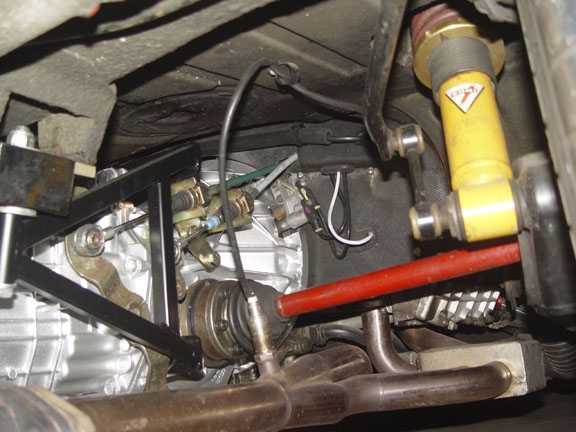

That's odd, my axle flanges are smaller than the 911 CV's. (IMG:http://www.914world.com/bbs2/html/emoticons/screwy.gif)
BTW, here's a tranny bracket from a guy who installed a Boxster 6 speed in his 914 (w/4cyl).
