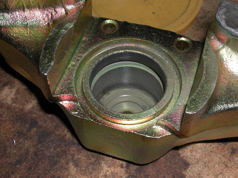

they will need a rebuild in the near future. In particlular the rear dust covers are ripped.
Do it, or have it done in the "very" near future. With torn dust covers water gets in there and collects on the upper edge of the cylinder just before the seal. The piston seal generally prevents the water from going much further but you know what happens when water and iron meet (IMG:http://www.914world.com/bbs2/html/emoticons/biggrin.gif)
If you want, I can spread the love with a few new dust covers and clips but... if you're having adjustment problems then it sounds like you might be do for a rebuild. The torn seals have probably allowed some water in.
Here's a picture that shows the cylinder. The upper edge above the seal ring gets rusty.
