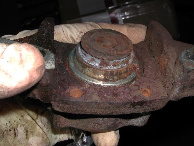

Here's what the rust does to the piston and cylinder.
solex   Brakes, Brakes, Brakes   May 16 2005, 09:27 AM

Eric_Shea   Here's what the rust does to the piston and cy...   May 30 2005, 11:51 AM
Eric_Shea   (Have I scared you enough yet? Get some rebuild k...   May 30 2005, 11:52 AM
