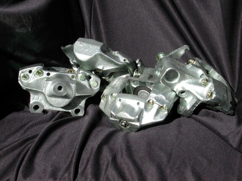

how much to have them rebuilt? Could you also quote on the price to do the fronts if I supply the complete front rebuild kits?
$225 Front
$225 Rear
-$30 Kit Credit
$15.40 Shipping (two Priority Mail Boxes)
$435.40 Total
I'll need your cores and kits. You get this back: (IMG:http://www.914world.com/bbs2/html/emoticons/wink.gif)

Eric_Shea
  May 30 2005, 02:07 PM SpecialK   Those are friggin' beautiful Eric!!   May 30 2005, 04:42 PM
Eric_Shea   Thanks Kevin, I need to publicly add that Kevin i...   May 30 2005, 09:53 PM
