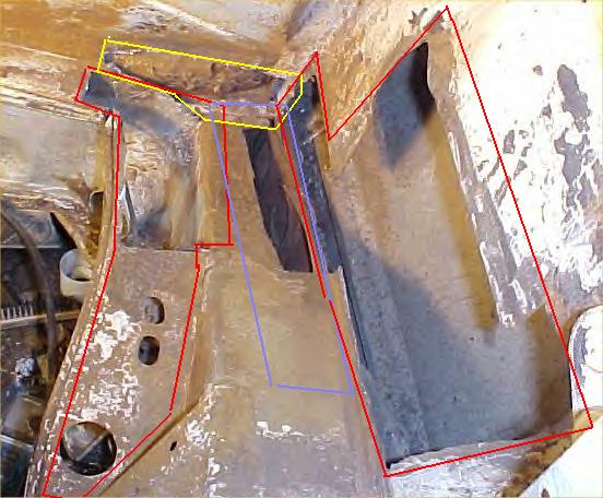

Here is an outline of what is replaces (thanks Trekkor)

Engman   Here is an outline of what is replaces (thanks Tre...   Jun 19 2005, 11:26 PM
