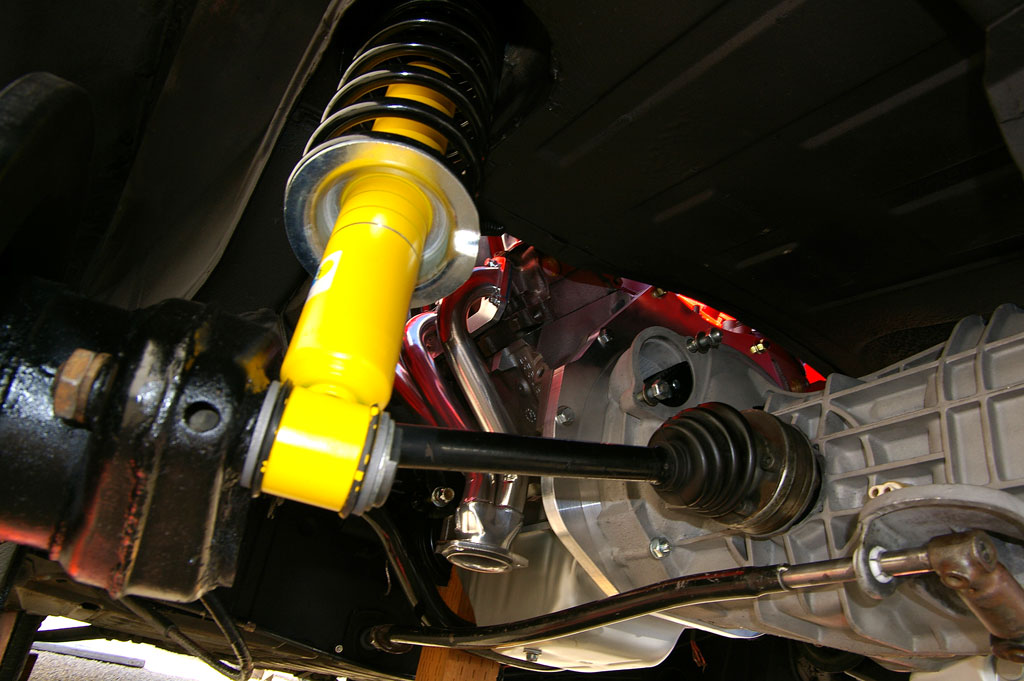

Got the engine & transaxle into the car, bolted up at the back, and ready to fabricate a few minor parts to make the new forward crossmember mate to the body. The forward crossmember was bought from Speedway Motors in Lincoln Nebraska for a grand total of $58 to my door (http://www.speedwaymotors.com/). The crossmember clears the shift linkage just fine. (IMG:http://www.914world.com/bbs2/html/emoticons/mueba.gif)

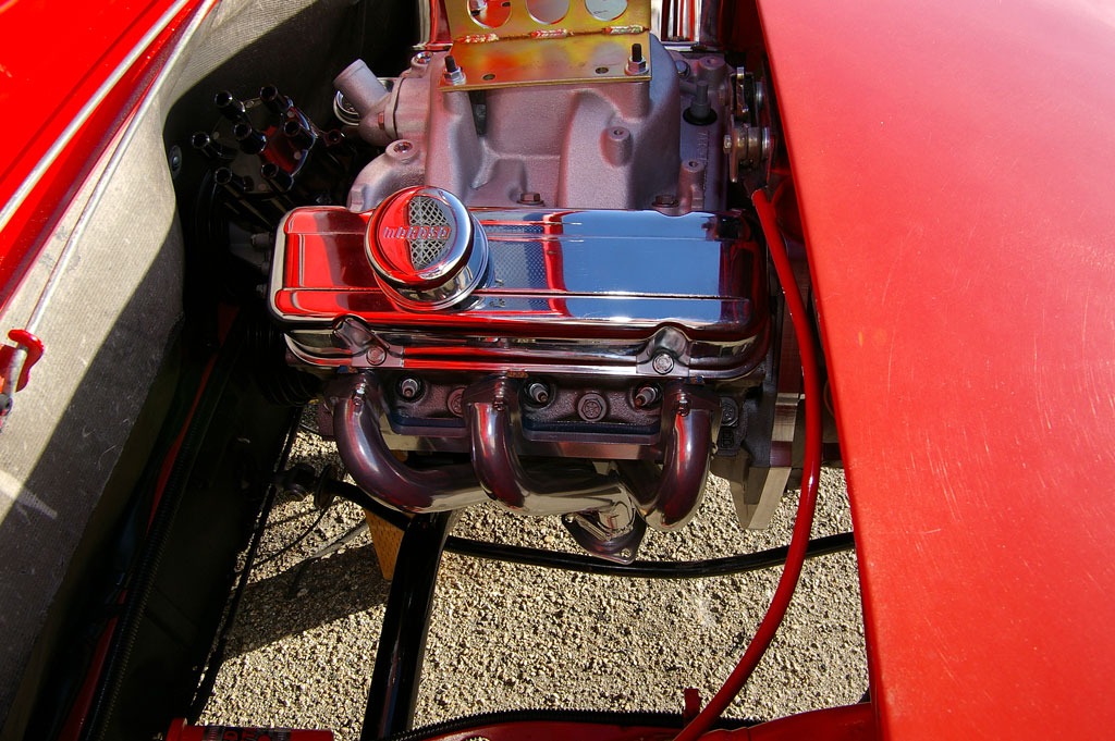

dbledsoe   I mounted the coil to the old heater blower mount ...   Oct 4 2005, 10:05 AM
dbledsoe   A tad short on carb to engine lid clearance thanks...   Oct 4 2005, 10:07 AM
dbledsoe   I can close the engine lid but I had to cut out th...   Oct 4 2005, 10:10 AM
