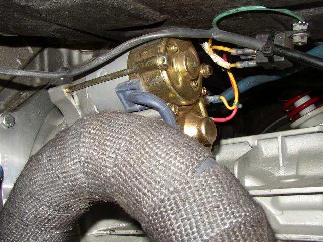

I'm doing a V6 Buick conversion with adapters, etc. from Kennedy Engineered Products. I also bought an IMI High Torque starter from them. The only thing is, it won't clear the trunk floor so I can put it in. (IMG:http://www.914world.com/bbs2/html/emoticons/confused24.gif) The starter is IMI's #101, which is what Kennedy sent me knowing, I believe, that it was going into a 914. Anyone else run into this problem? Or, what starter did you end up using for your V6 or V8 conversion.

Senior Member ![]() ![]() ![]() Group: Members Posts: 1,101 Joined: 11-October 04 From: Tucson Member No.: 2,923 Region Association: Southwest Region |
Mine looks the same as yours John. About 1/4" clearance.

dbledsoe Here's a picture of the starter on the engine.... Jul 6 2005, 08:54 AM
