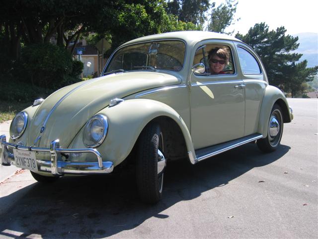

i still have this to play with.
I'm talking about the car.
