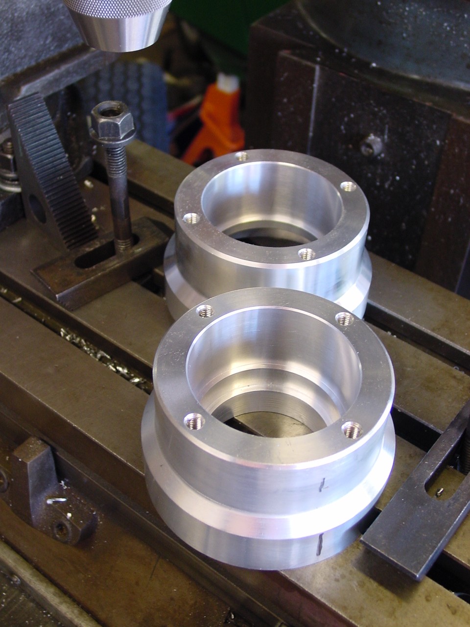

I started thinking in steel, went to aluminum, then back to steel. I got cught up with the aluminum version mainly due to the weight advantage, ease of machining, and went forward with less than adequate data. I bought all the proper aluminum materials. I even machined up the bearing carriers. In parallel, I was persuing data on aluminum welded (suspension) structural requirements, only to find in the end that it would require extraneous post weld treating (read $$$). Even with that, there would remain some degree of doubt without a proper testing regime (fatigue life, sudden failure, and so on). It just wasn't worth the risk. So, my decision was simple; make them from steel, and rest at ease.
The weight of these trailing arms is basically the same as a stock trailng arm with a stiffening kit installed. Unseen in the pic, is a structure buried inside that adds considerable strength.
Below pic is of two nearly completed aluminum bearing carriers/paper weights (IMG:http://www.914world.com/bbs2/html/emoticons/wink.gif)
