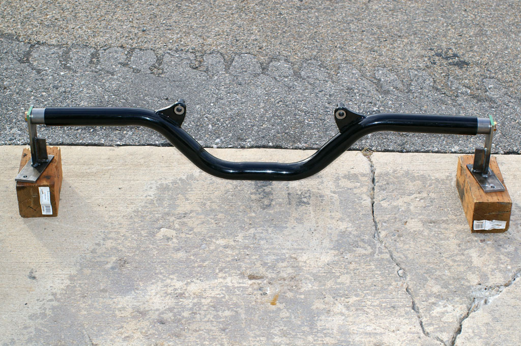

Got the engine & transaxle into the car, bolted up at the back, and ready to fabricate a few minor parts to make the new forward crossmember mate to the body. The forward crossmember was bought from Speedway Motors in Lincoln Nebraska for a grand total of $58 to my door (http://www.speedwaymotors.com/). The crossmember clears the shift linkage just fine. (IMG:http://www.914world.com/bbs2/html/emoticons/mueba.gif)

I finally got around to completing the forward motor mount/cross member (see photos below). Since I couldn't find any already made I came up with my own design using the cross member for a Buick V6 into a street roadster available from Speedway Motors ( http://www.speedwaymotors.com/xq/aspx/disp.../qx/product.htm ) for $50. The photo shows a close up of how I adapted it to fit the 914 chassis. My cross member sits on top of the 914 forward frame/body mounting points rather than hanging below them as do other V6/V8 conversion forward cross member/engine mount set ups. And because mine sit atop there must be a provision in the mount to make it narrower for installation and removal. To accomplish that I used 1.5" steel bar stock to slip inside the cross member allowing the mounting pad to telescope in and out for installation. Once installed they are held in position by a pair of 3/8" bolts running though the cross member and the bar stock tying both together. Total cost was about $80 for the complete motor mount/cross member.
Tonight I'll paint the end pieces and do the final installation in the car. That will complete the engine end of the car and then I can concentrate on the colloing system.
