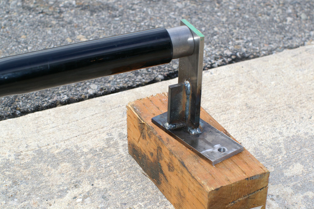

dbledsoe   I finally got around to completing the forward mot...   Jul 22 2005, 10:33 AM
dbledsoe   Close up of end piece.   Jul 22 2005, 10:34 AM
