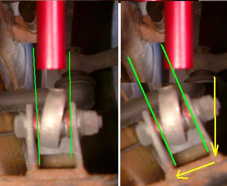

I figure the lower heim joint broke off while it was pointing inward, at full compression.
This is hard for me to explain, but I think the problem is the 90 re-orientation of the u-tabs and I think the axis of the heim joint on the a-arm needs to be parallel to the axis of the a-arm itself.
If you put a big plate (green lines) into the rotated u-tab, you'd see that the plane of the plate (especially the top) move inward and outward through the a-arm travel. However, the top of the droplink in fixed in its left-right orientation, and at some point the droplink tries to bend.
The forces on the utab (yellow) push down, but since the u-tab is at an angle, 'down' is also 'inward'.
(The left side of the picture is at ride height, the right side is my interpretation of a-arm, u-tab orientation at full compression.)
