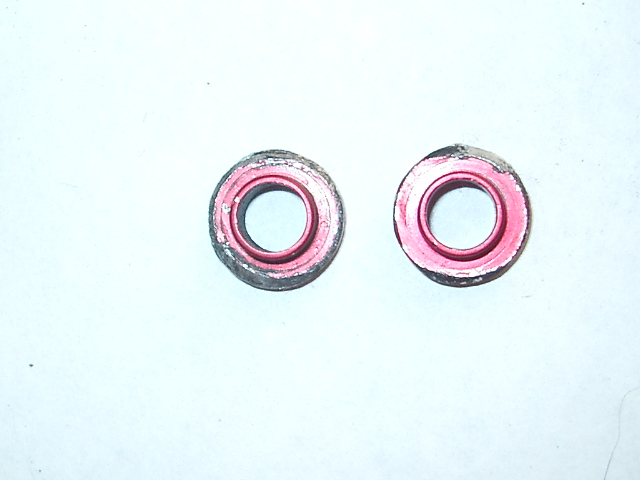

i believe the u-tabs came with your kit as those a-arms didn't have tabs on them ...
i'll try to take another closeup of those tomorrow.
for now, here are a few closeups of the (deformed) spacers ...
NOTE: each of the spacers was the outside spacer on the lower himejoint.

Demick   so clearly the heim hit the spacers before hitting...   Aug 4 2005, 08:01 PM

Cloudbuster   It looks as if those u-tabs ARE too far inboard. ...   Aug 4 2005, 08:27 PM
Eric_Shea   Those U-Tabs look to be about 1/2" too far inward ...   Aug 4 2005, 08:31 PM
