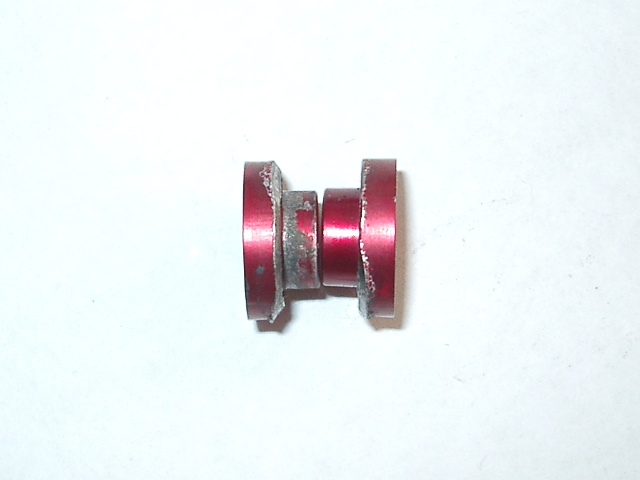

so on my way to the AX saturday i noticed a "clunk" sound from the frontend, like i had lost something.
i had this happen before, bolt came lose on the swaybar droplink, so i thought that was it ...
when i get to the AX site and change tires, i see the droplink hanging all weird so i take a closer look and the lower hime joint has broken. the thread just snapped off the joint.
i then continue to change the tire on the other side and it's exactly the same! (IMG:http://www.914world.com/bbs2/html/emoticons/ohmy.gif)
both hime joints broke in the exact same location. that seems too odd to be coincidence.
i must have hit something *really* hard for that to happen, but i can't remember running over any bad potholes etc.
anyone else had problems before?

SirAndy   alright, let me say first that i really apprechiat...   Aug 4 2005, 12:45 PM
SirAndy   drivers side: note how the hime joint is stuck al...   Aug 4 2005, 12:49 PM
SirAndy   pass side: same here, hime joint was stuck toward...   Aug 4 2005, 12:53 PM
SirAndy   and out of the car ... http://www.914world.com/bb...   Aug 4 2005, 12:54 PM

SirAndy   so it looks like all i need is two lower hime-join...   Aug 4 2005, 12:57 PM

Dave_Darling   Pics of the actual failure site may be able to tel...   Aug 4 2005, 01:13 PM

Cloudbuster   I figure the lower heim joint broke off while it w...   Aug 4 2005, 02:00 PM

Dave_Darling   It's tough to tell from the pics (mostly due t...   Aug 4 2005, 02:49 PM

Demick   Another consideration is that the lower heim joint...   Aug 4 2005, 04:20 PM
SirAndy   here's another observation .... the way the t...   Aug 4 2005, 04:23 PM

Cloudbuster   The problem is that the upper heim joint is fixed ...   Aug 4 2005, 05:47 PM
McMark   Did the heim joint run into the UTab or the spacer...   Aug 4 2005, 06:08 PM
SirAndy     Aug 4 2005, 06:14 PM
McMark   On the bottom. The top seems irrelevant, since it...   Aug 4 2005, 06:27 PM

Demick   so clearly the heim hit the spacers before hitting...   Aug 4 2005, 08:01 PM
SirAndy     Aug 4 2005, 08:02 PM
Cloudbuster   It looks as if those u-tabs ARE too far inboard. ...   Aug 4 2005, 08:27 PM
Eric_Shea   Those U-Tabs look to be about 1/2" too far inward ...   Aug 4 2005, 08:31 PM
