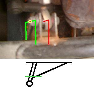

It looks as if those u-tabs ARE too far inboard. According to my (3rd) spare set of factory a-arms, the bolt hole should be even with the inside corner of that tubular brace on the a-arm. (No camera, so I get to play with Paint some more)

Cloudbuster   It looks as if those u-tabs ARE too far inboard. ...   Aug 4 2005, 08:27 PM
Eric_Shea   Those U-Tabs look to be about 1/2" too far inward ...   Aug 4 2005, 08:31 PM
