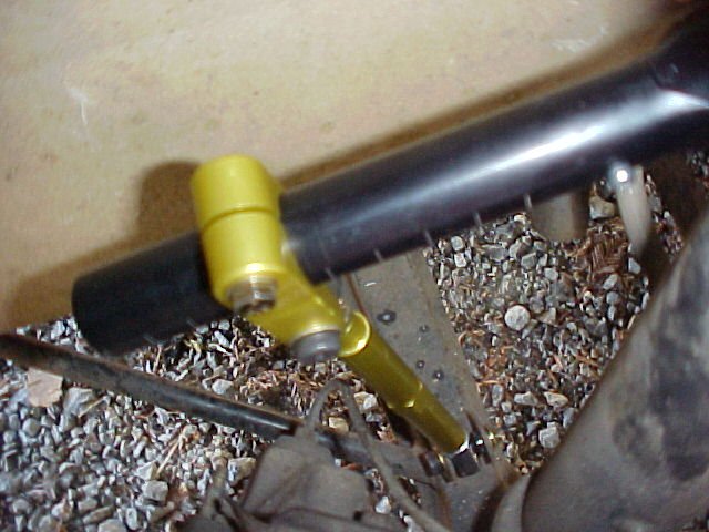

so on my way to the AX saturday i noticed a "clunk" sound from the frontend, like i had lost something.
i had this happen before, bolt came lose on the swaybar droplink, so i thought that was it ...
when i get to the AX site and change tires, i see the droplink hanging all weird so i take a closer look and the lower hime joint has broken. the thread just snapped off the joint.
i then continue to change the tire on the other side and it's exactly the same! (IMG:http://www.914world.com/bbs2/html/emoticons/ohmy.gif)
both hime joints broke in the exact same location. that seems too odd to be coincidence.
i must have hit something *really* hard for that to happen, but i can't remember running over any bad potholes etc.
anyone else had problems before?

how about a lower mount that goes around the small round support rod on the a-arm with a top that can move freely and won't hit anything?
That's the set up that is used with SRP's front bars.
If you can't pivot the drop links with the car on the ground, that is a problem to start with.
The hime joints need to be centered and parrelell with the u-tabs.
here's the drops attached to the stock u-tabs.
KT

SirAndy   alright, let me say first that i really apprechiat...   Aug 4 2005, 12:45 PM
SirAndy   drivers side: note how the hime joint is stuck al...   Aug 4 2005, 12:49 PM
SirAndy   pass side: same here, hime joint was stuck toward...   Aug 4 2005, 12:53 PM
SirAndy   and out of the car ... http://www.914world.com/bb...   Aug 4 2005, 12:54 PM
Mueller   I wonder if moving the link out .25" to .375" woul...   Aug 4 2005, 12:55 PM
SirAndy   so it looks like all i need is two lower hime-join...   Aug 4 2005, 12:57 PM

Dave_Darling   Pics of the actual failure site may be able to tel...   Aug 4 2005, 01:13 PM
SirAndy     Aug 4 2005, 01:38 PM
Cloudbuster   I figure the lower heim joint broke off while it w...   Aug 4 2005, 02:00 PM

Dave_Darling   It's tough to tell from the pics (mostly due t...   Aug 4 2005, 02:49 PM
john rogers   Has anyoner snapped a bolt off? Remember what hepp...   Aug 4 2005, 03:10 PM
airsix   I don't think heim joints are compatible with ...   Aug 4 2005, 03:13 PM
Cloudbuster   Even if the droplink is shortened, the mounting po...   Aug 4 2005, 03:53 PM

Demick   Another consideration is that the lower heim joint...   Aug 4 2005, 04:20 PM
SirAndy   here's another observation .... the way the t...   Aug 4 2005, 04:23 PM

Cloudbuster   The problem is that the upper heim joint is fixed ...   Aug 4 2005, 05:47 PM
McMark   Did the heim joint run into the UTab or the spacer...   Aug 4 2005, 06:08 PM
SirAndy     Aug 4 2005, 06:14 PM
McMark   On the bottom. The top seems irrelevant, since it...   Aug 4 2005, 06:27 PM

Demick   so clearly the heim hit the spacers before hitting...   Aug 4 2005, 08:01 PM
SirAndy     Aug 4 2005, 08:02 PM
Cloudbuster   It looks as if those u-tabs ARE too far inboard. ...   Aug 4 2005, 08:27 PM
Eric_Shea   Those U-Tabs look to be about 1/2" too far inward ...   Aug 4 2005, 08:31 PM

trekkor   I have never raced with the stock u-tabs. When I ...   Aug 5 2005, 12:22 AM
Ira Ramin   Ok Andy, I have an idea that will solve your probl...   Aug 5 2005, 07:48 AM
