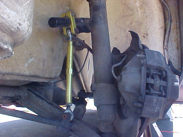

Here's the lower mounts installed below the stock u-tabs.
You can buy just the lower mounts from Smart.

SirAndy   alright, let me say first that i really apprechiat...   Aug 4 2005, 12:45 PM
SirAndy   drivers side: note how the hime joint is stuck al...   Aug 4 2005, 12:49 PM
SirAndy   pass side: same here, hime joint was stuck toward...   Aug 4 2005, 12:53 PM
SirAndy   and out of the car ... http://www.914world.com/bb...   Aug 4 2005, 12:54 PM
Mueller   I wonder if moving the link out .25" to .375" woul...   Aug 4 2005, 12:55 PM
SirAndy   so it looks like all i need is two lower hime-join...   Aug 4 2005, 12:57 PM
SirAndy     Aug 4 2005, 12:59 PM

Dave_Darling   Pics of the actual failure site may be able to tel...   Aug 4 2005, 01:13 PM
SirAndy     Aug 4 2005, 01:38 PM
Cloudbuster   I figure the lower heim joint broke off while it w...   Aug 4 2005, 02:00 PM

Dave_Darling   It's tough to tell from the pics (mostly due t...   Aug 4 2005, 02:49 PM
john rogers   Has anyoner snapped a bolt off? Remember what hepp...   Aug 4 2005, 03:10 PM
airsix   I don't think heim joints are compatible with ...   Aug 4 2005, 03:13 PM
Cloudbuster   Even if the droplink is shortened, the mounting po...   Aug 4 2005, 03:53 PM

Demick   Another consideration is that the lower heim joint...   Aug 4 2005, 04:20 PM
SirAndy   here's another observation .... the way the t...   Aug 4 2005, 04:23 PM

Cloudbuster   The problem is that the upper heim joint is fixed ...   Aug 4 2005, 05:47 PM
McMark   Did the heim joint run into the UTab or the spacer...   Aug 4 2005, 06:08 PM
SirAndy     Aug 4 2005, 06:14 PM
McMark   On the bottom. The top seems irrelevant, since it...   Aug 4 2005, 06:27 PM

Demick   so clearly the heim hit the spacers before hitting...   Aug 4 2005, 08:01 PM
SirAndy     Aug 4 2005, 08:02 PM
Cloudbuster   It looks as if those u-tabs ARE too far inboard. ...   Aug 4 2005, 08:27 PM
Eric_Shea   Those U-Tabs look to be about 1/2" too far inward ...   Aug 4 2005, 08:31 PM

trekkor   I have never raced with the stock u-tabs. When I ...   Aug 5 2005, 12:22 AM
Ira Ramin   Ok Andy, I have an idea that will solve your probl...   Aug 5 2005, 07:48 AM

Jeroen   here's a pic of the location of the stock u-ta...   Aug 5 2005, 01:42 PM
SirAndy     Aug 5 2005, 02:26 PM
Jeroen   I just took a look at my tarret droplinks (have be...   Aug 5 2005, 02:32 PM
