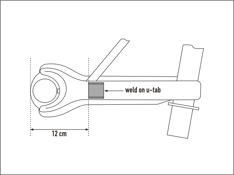

here's a pic of the location of the stock u-tabs

Jeroen   I just took a look at my tarret droplinks (have be...   Aug 5 2005, 02:32 PM
