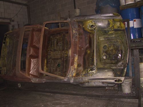

Went to the dry-ice blasting shop, today. They are done with the "parts" i.e the doors, the hoods etc . . . and are working on the tub. The underside is pretty much done, from what I could see. I spoke to the guy doing the actual cleaning and he says they found very little rust. I saw a few small holes, pencil size on the trunk floors, but that was it. I may find more when it's home.
The dry ice is not very agressive and they've been using stripper first, then the blasting. Here's a shot of the stripper stewing in the front trunk:
