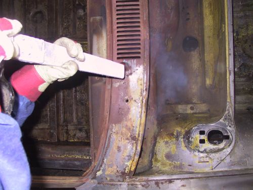

And the actual blasting. The blue-gray cloud to the right of the area being blasted is the CO2 ice turning to a gas. In the picture, the operator is blasting an area that was cleaned previously, and there is absolutely nothing being thrown off the car, i.e. no residue from the blasting itself.
One concern, though, is that the blasting "gun" is pretty big and cumbersome, and I'm not sure how it's going to work out in some of the more out-of-the-way spots on the tub.
BTW the process is noisy as hell. No way I could have gotten close if they had'nt given me a pair of ear plugs.
